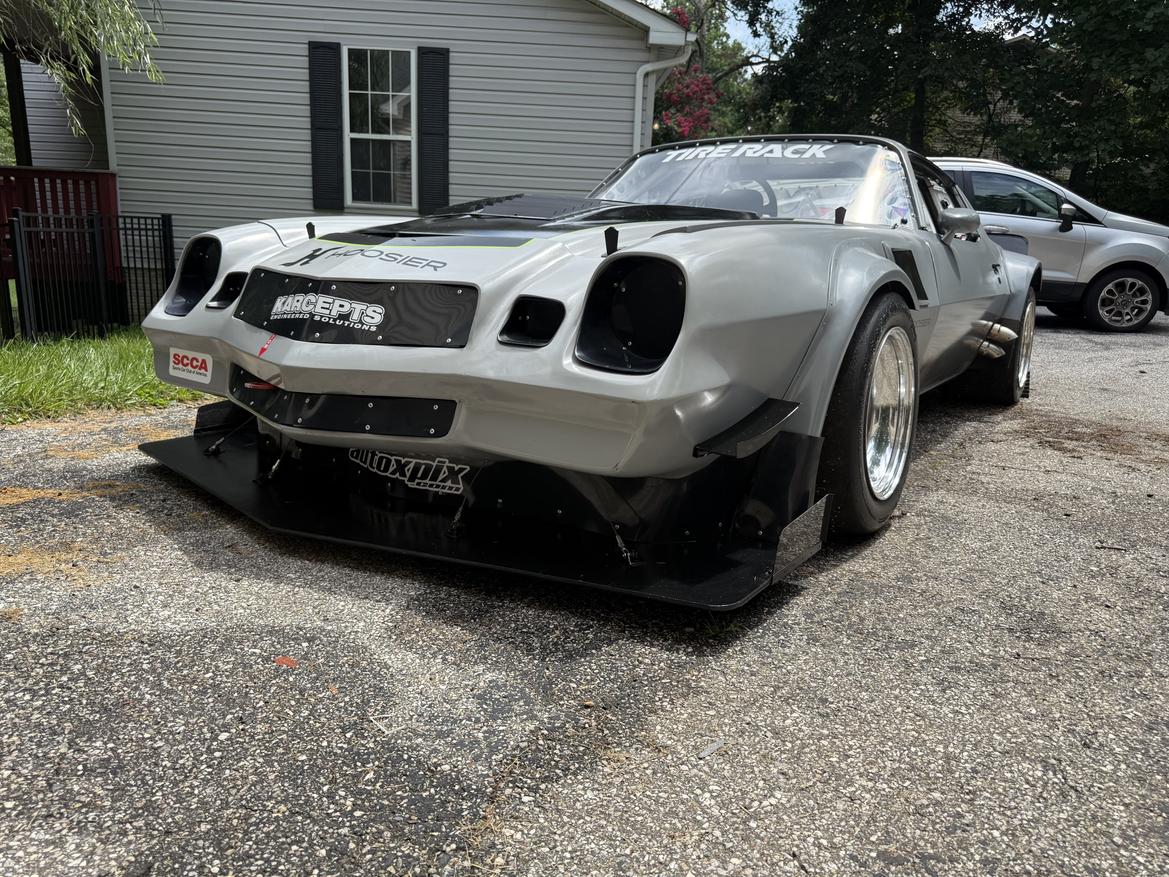

When I got back into town, I finished 3D printing some canards for the front of the car.
If you want to see more on that, just hop to my other thread here - https://grassrootsmotorsports.com/f...-location-design-angle-and-size/233541/page2/

Hadn’t checked in on this build in a while, wow!
Been looking at learning Fusion 360, on the canard design, is there an iphone scanner app or was it just a picture imported into Fusion? Discovering there is much to learn in 3D printing and an incredible amount of materials and technologies available, at various prices of course.
1981paul
Moderator
Jan 21, 2000
2,775
Catonsville, Maryland MD USA
Thanks!
My phone (iPhone 16 Pro Max) has built in lidar, but I had to use an app called "Polycam" to get the data. It has a monthly fee, but I just used it once for this project and then cancelled.
I'm pretty excited about what we can do at home with 3D printers now, and I have a basic cheap one. I'll be upgrading in the future for sure so I can do more functional prints for the car.
