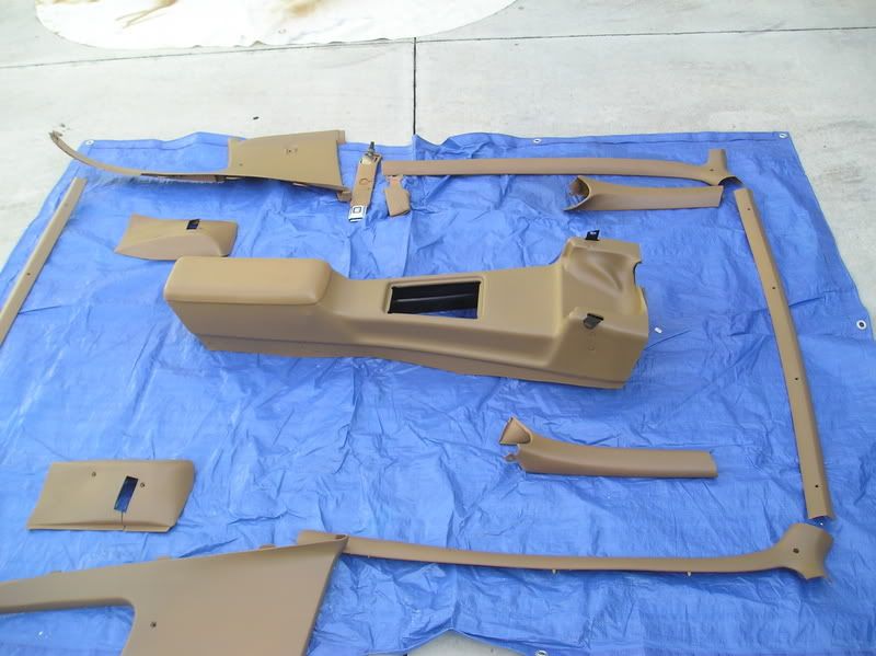

I used SEMS Landau black on all my interior plastic pieces. Everything turned out great!! I was wondering if the same stuff can be used on the metal A pillars, and upper metal front and rear glass trim pieces?? I would like these metal pieces to have the same sheen as the rest of the plastic interior pieces. I read the can, as well as looked around their website. I saw no mention of using the SEMS on metal.
Any others do this??
Thanks!
