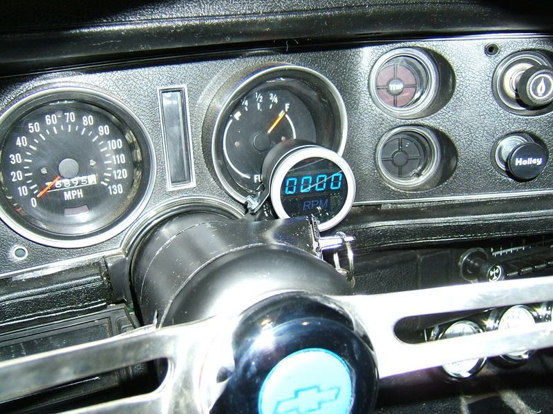

no hole in your firewall currently that you can fish the cable through?
got mine hooked up where the old rear defroster used to be..
