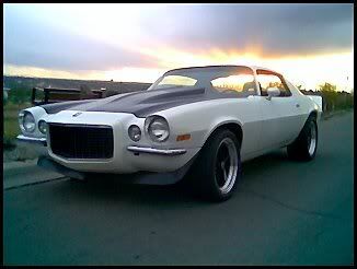

[IMG][/IMG] 73 rs w/ 17x8's and 17x 9's w/ 245 and 275 40 17's. i did the herb adam's mod a few year's ago, and if i remember correctly, the article stated that it would help the car squat better, as well as lower the body CG in relationship with the suspension... make's sense !
