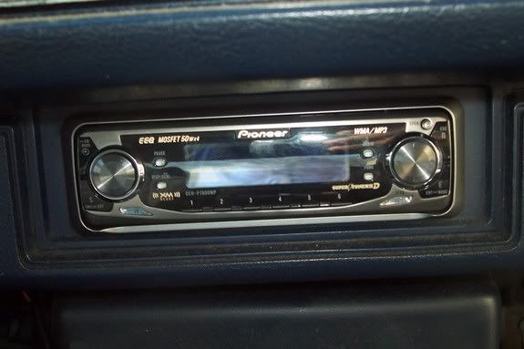

heres what mine looks like in my dash its a pioneer deh-7600mp i think anyway it was easy to cut the dash and it looks pretty good imo the interior is blue and it lights up with blue accents so it looks pretty good
hey thats the same stereo i installing in my car.thanks now i know what its going to look like.
