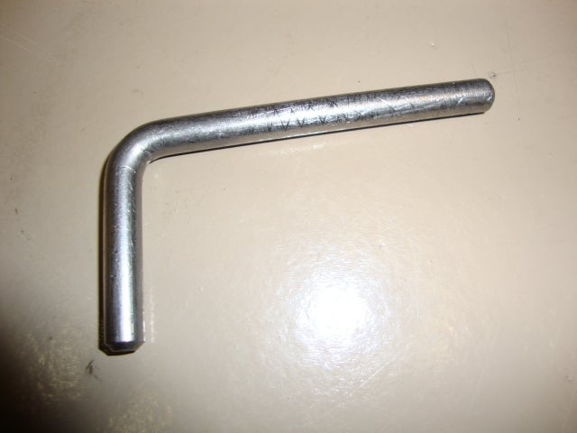

Shifter adjustment http://www.nastyz28.com/~copo/images...%20shifter.jpg
The tool must be snug and fit like this.
well i'll be a SOB....allen wrench was giving me enough slack to cause this catch, a stanley screwdriver took one for the team. Pulled off the end, bent it with the torch and BINGO......my slop is gone....car shifts perfect...who woulda thunk that? Thanks a million
