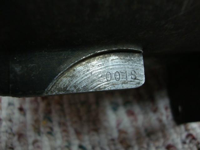

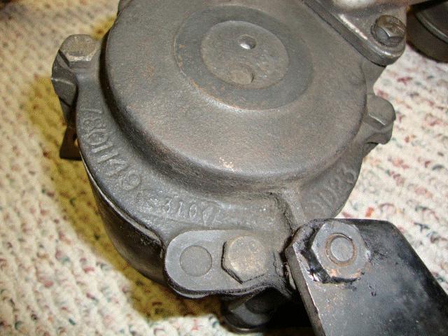

Mine
120=120th day
0=1970
1=1st shift
S=Saginaw Plant
Rear - 7801149 310 D23
My car build date is 05E

Originally Posted by Budz
I searched, but want to be sure.
Is this the correct breakdown for this date code: 07501S
075= 75th day (March 16)
0= 1970
1= shift
S= plant
Casting # on back cover: 7801149
The letter "S" is not the plant. It is the broadcast number or pump model.
Examples of other stamped codes on smog pumps:
"11561E"
"0381Y1"
"14711P"
