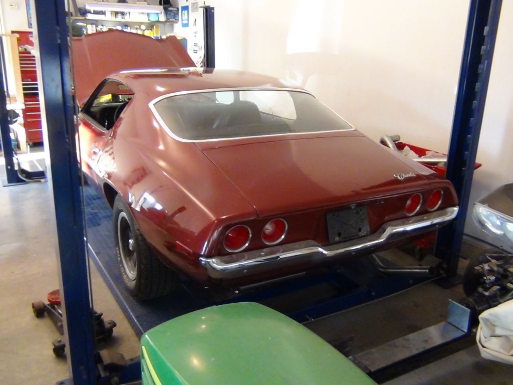

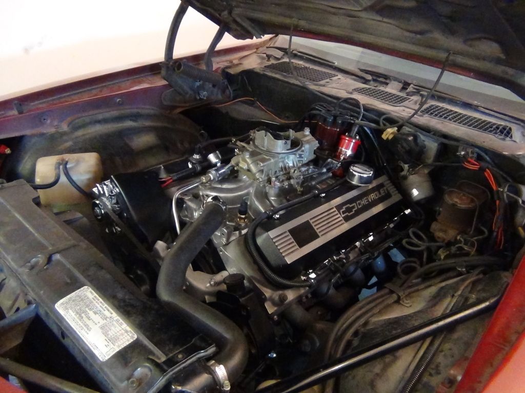

Here's mine with a Torker 2
I need a 2" air filter and a drop base

BB 73, I was looking at the Torker 2 how much drop do you have in your breather base? An 2" element seems awful small.

Fitting a Big Block under a flat hood isn't about high rpm's and max horse power.
I like the stock look over a hood scoop and the stealth .
My hood closes with the 3" filter but no lid.I haven't had the time to experiment with the lid,I haven't bought a 2" filter and will only do so after trying all option's.

The base I have looks like the 14" drop base on this link
http://www.knfilters.com/Racing/cuslids.htm

The drop base I have can't go any lower before hitting stuff
