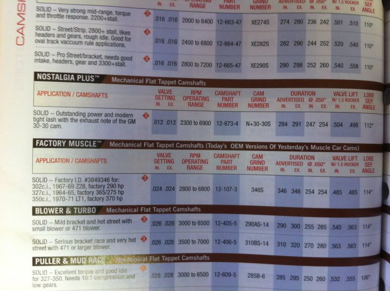

Here are some cams I am looking at. I want something that will sound like this and perform well and be reliable and drivable. The best of all worlds.
http://www.compcams.com/base/multime...ompcams278.mp3
Stock GM cam that was in the LT1
3972182 Mech. 242/254 .459"/.485" 11.0:1 116
GM 140 Off Road Racing Cam First Design
3927140 Mech. 257/269 .493"/.512" 12.0:1 112
Ultradyne
531259 278/282 .248/252 & 530/541 108
2 other suggestions
