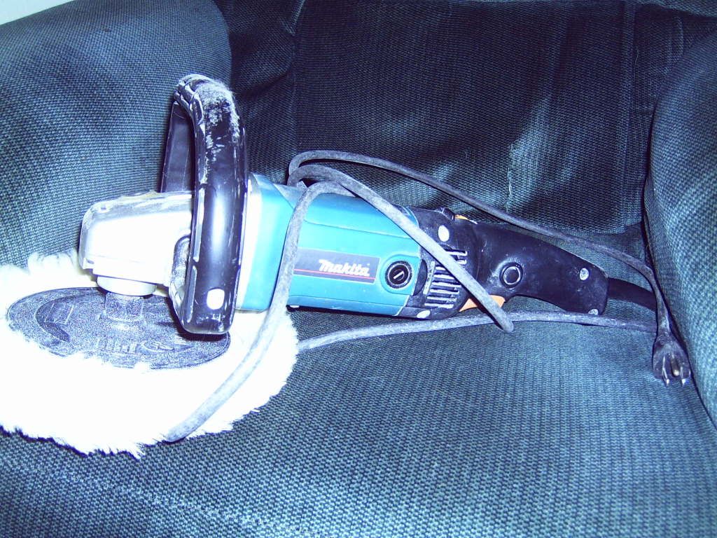

Get one of these. One of the most used tools I own. I would not wet sand it though. You don't want to take off more than you have to. Most old dull paint will come alive if you buff it. Just be careful on the edges.

I would not use a heavy duty compound as it will cut off to much paint. Start with a medium duty and a 2" pile wool pad. If you can get a buffer with adjustable speed it makes it easier to get into tight spaces. Be careful on sharp edges and always make sure your buffing pad turns away from an edge and not into it as edges are easy to burn through. After using the medium duty compound use a polish/swirl remover and a black foam pad. Third, post up some pictures of how it comes out. Should look pretty good. Good Luck.
