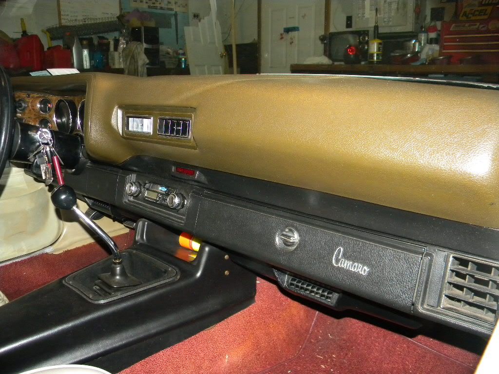

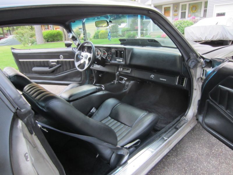

here is my 73 and no lever to open and close . just a little finger grip thing to shut the louvers . louvers are dash texture on the close side .. are you sure there from a camaro ? all the second gens ive seen look like mine , but maybe its a 70 thing ?

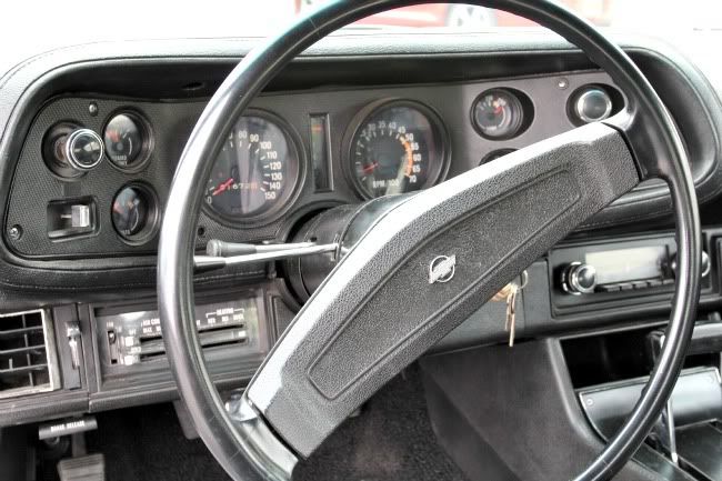

i was cruising ebay and found 2 70 camaros with A/C and low and behold , a chrome lever to shut off the air supply . just 1 more thing that was a 70 only thing... as far as grafting them onto the new piece , i couldn't tell you as i can't see the working parts . but here it is ...

Interesting. I hadnt seen that before either,

Looks like that would be on the housing for the vent but i'v never seen one before...hmm

i guess they would work , but if you notice the louvers on the non A/C vents are vertical and larger . the A/C vents are horizontal and have the small blocked off area on the inboard side . I'm not sure of the goose neck angle either from A/C to non A/C
