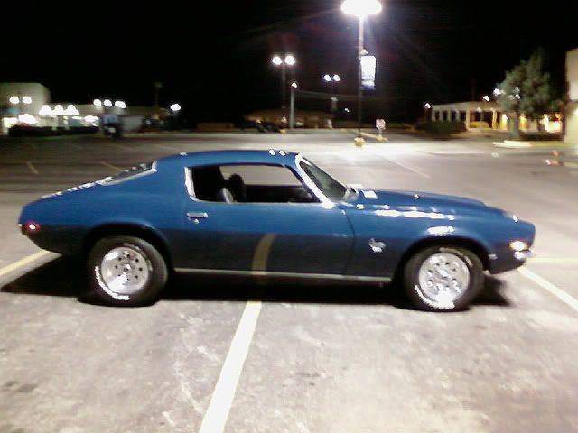

I have the sizes you're looking at on my car. Weld Draglites. 15x8.5 in the rear with 275/60/15", 15x6 in the front with 215/70/15.
The rear backspace is 4.5". The front is 4".
Sorry it's not black, nor the style of wheel you want, but the sizes are close.
