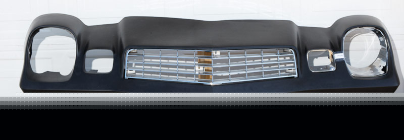

Today we will be reviewing the 1978-81 Urethane Front Bumper sold by GroundUp (SS396).
Note: This is not the fiberglass nor the flex-glass version. I chose this product because I liked the fact that it was the same urethane material as the original car and provides a little flexibility, which fiberglass does not.
On with the review!
Test Subject GroundUp Urethane Front Bumper
Compatible Models 1978 through 1981
Manufacturer New Dawn Enterprises (Sold through GroundUp, Classic Industries, etc.)
Reproduction Part #
Country of Origin USA Baby!
Vendor GroundUp (SS396)
Vendor Part # LBC-305
Price $445
Control Group OEM from a 1978 Camaro
First Impressions
My first impression was overwhelmingly positive. The bumper is black urethane that is clearly well machined and well designed. Don’t expect fancy packaging – the item came wrapped in thick bubble wrap in a thick, plain cardboard box branded with GroundUp’s name on it.

I tend to be a very detail-oriented person, so this product description from the GroundUp website really appealed to me:
This is an exact reproduction 1978-1981 Camaro urethane front bumper cover for all models including Z28. Painstakingly reproduced in durable high strength urethane with strict attention to detail.

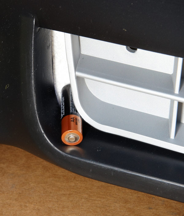

I do want to point out one thing that could be an issue, but I will need help from you guys to confirm this.
Several years ago, I bought an upper grille that was marketed as NOS, but which I later came to suspect was a repop of some kind. On a whim, I mounted this to my GroundUp bumper and noticed there was a significant gap on either side of the grille – either my grille isn’t wide enough or the opening on the bumper is too wide – or both. This really bothers me because I don’t remember there being such a big gap before.
The opening for the Upper Grille on the OEM bumper is 29 ¾ inches wide, but my OEM bumper is in really rough shape and it is possible the Urethane has shrunk or been otherwise deformed, which is skewing the measurement.
* The GroundUp opening is about 30 1/8 inches wide
* The Upper grille I have (a repop of unknown origin) is 29 1/2 inches wide.
Help!
If anyone can post measurements of their Upper Grille opening, from the angle shown below – or post measurements of the overall width of an OEM upper grille, I would be very appreciative. I am really hoping the opening on this bumper isn’t wider than it needs to be. I vaguely remember a small gap, but not ½ an inch on either side.

this peaked my interest and i went outside and measured and my opening is a little over 29 1/2 wide.

Im really hoping this isnt going to be an issue but mine is nearly 1/2 to 3/4th of an inch wider. Im about two weeks away from being ready for paint. Im going to take some more measurements tmrw.

Agreed - this is why I asked for other people to provide a measurement. I dont have an OEM grille anymore to compare against, but I did do some research on them and it appears most of them appear to be 29.5 at the widest point (across the bottom most horizontal rail). The repop that I have is exactly 29.5 inches wide.
With the GroundUp's front bumper upper grille opening coming in at roughly 30 to 30 1/8... that means that it is potentially hald an inch too wide. That may not sound like much, but I will post some pics so yall can see this... it's a big gap once you look at it head on. (The lower grill opening is 30 inches wide, which appears to mirror the OEM bumper. It's a little difficult to measure, but people who are using an OER lower grille will definitely notice a 1/2 gap on either side of the lower grille.)

Thanks Cruzer! This is definitely validating what I was afraid of.
I am going to take some more measurements and do a test fitting with the lower grille, the parking lamps, and the headlight bezels too so we can see how that shapes up.

Going back to the original issue, here are some shots taken with an upper grille that measures 29.5" at it's widest point (measured from the back, bottom point to bottom point, as shown below).
I want to point this out although I this probably is not an issue In the image below, you will see that there are two small screw holes in the OEM bumper (circled) that are not present in the GroundUp bumper. You will need to drill these holes back into the bumper (possibly before you paint it.). EDIT. These holes may be used to secure the bumper to the filler panel.
