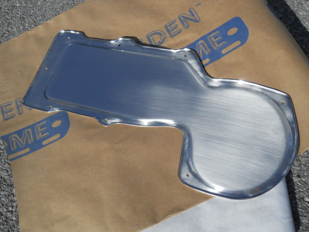

I purchased this one from DSE and sent it off for a brushed nickel finish. It is listed on their website under the 67-69 year model and fits the 2nd Gen. I am testing a plater so keep an eye on my project. They pick up and return your parts for you, 50% deposit and balance only if you are satisfied. Doing bumpers and other exterior items in this finish.
