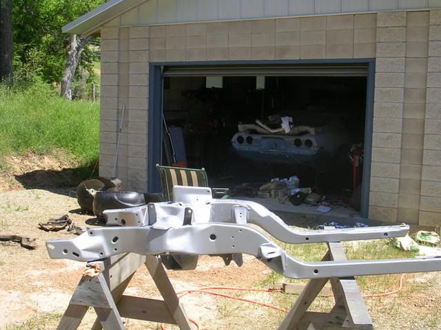

Welcome to the site gorilla, nice looking motor ya have there. Love the color of the sub-frame.

thank you for the info. I powdercoated the subframe a Silver Vain color, cant tell but its actually silver with black hammer tone effects in it.

I did mine with Rustoleum hammered silver and got a lot of compliments on it. (While I had it that is)
