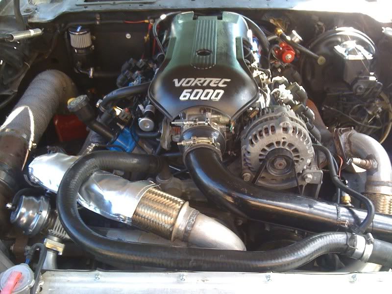

The day has finally come, dyno day in the am hopefully all goes well I would really like to make 550 hp my setup is
stock 6.0 ls lq4
04 ls6 cam
ls9 head gaskets
arp head bolts
60 lb inj
borg s475 turbo
stock exhaust mani's
stock intake
stock tb
th400 trans
10 bolt
planning on running about 14#s of boost

At first, I was thinking- "Dream on, I mean LS engines are good, but 550rwhp from a 6.0. Let's be realistic." And then I saw the hair dryer...

What fuel are you running? Do you plan on water/alky injection? How much timing is in your tune? 14 psi on 10:1 compression with 91 octane should be interesting long term.............

The LQ4 is the perfect stock block to turbo with 9.4 compression, not 10:1. Im doing a LQ4 with L92 heads and LS3 intake, and a 76mm turbo. Good luck on the dyno, interested in the results

Looks Good. Let us know how it goes. Little concerned with the upper rad hose though. What hood are you running for clearance?

You're the 2nd guy with a 2nd gen I've seen get that Vortec truck intake to fit.
What did you your hood to get that truck intake to fit ??
What engine mounts and frame mounts did you use???

Top pic= little hood springs=fiberglass cowl hood. That's my guess.
