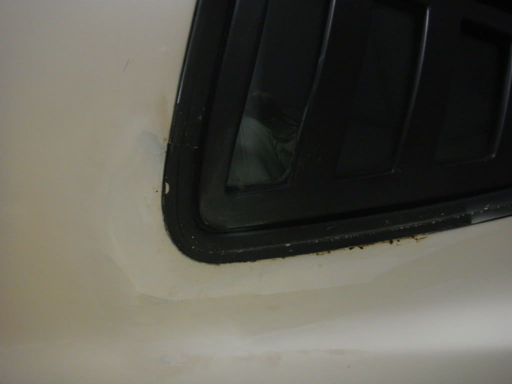

so took some pictures...what do you guys think about this area...looks like some rust some pointers on what i should do would be great...

I would have a GOOD body shop guy take a look at whats going on at the lower edge of the rear glass, could be the tip of the iceberg and needs to be dealt with sooner than later.
