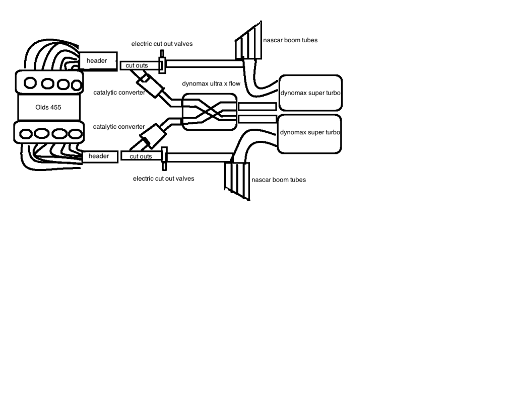

Originally Posted by hessdawg
so this is what i was thinking
in 2.5 inch
or do you guys think i need 3 inch???
Mufflers permitting, dual 2.5" ( mandrel-bent, of course ) will support 520 HP with NO restriction. 3" is just loud, drawing cops.
well im estimating my 455 to be in the 500-550hp range
so with the muffler aka(restriction) i should probably go with 3 inch
Why, you have Mondello or Edelbrock heads and a roller cam?
i would never buy mondello heads. I wish i had the money for edelbrocks right now i have extensively stock ported heads and intake
500-550hp is a really just wishful thinking

Anybody else have suggestions other than what is pictured?
I haven't done this yet, but intend to and I THINK it will work...
I have the long (20" case) Dynomax mufflers, which BTW I think are the same thing as the old Walker "hemi" super turbo's. For me, they are about right for normal driving, i.e. sounds good, but not obnoxious. However, there are times where I would like it to be quiet and cruise. I think if I install a single cut out just beyond the X-pipe, it will essentially convert the X pipe into a Y pipe and force all the exhaust through one muffler. For light throttle cruising that won't have any adverse effect and should be very quiet.
