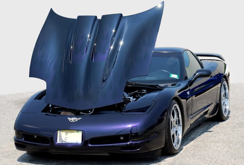

Ghost flames are cool when done properly no doubt. It is hard for me to tell in the pictures you posted how that would look on a whole car but if you like it go for it.
You may want to google motorcycles with ghost flames. My painter does a lot of ghost flames on motorcycles.

Here are two cars I got off of google.
