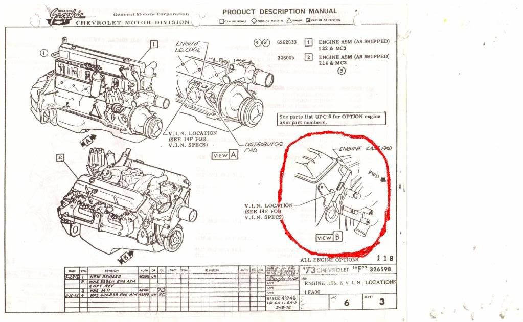

Posts: 7,724
i guess by 73 they figured it out ..
twozs is online now   Reply With Quote
