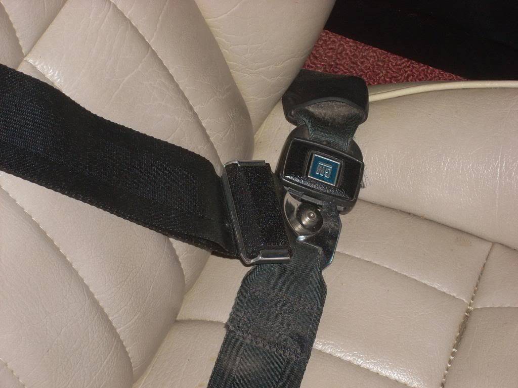

this is a 72 z28 i am finishing up, it has the original date coded belts, small buckles in the rear. these are the only pics i have right now, i will get some better ones in a day or two.

Thanx boardog, I appreatiate the pics, but somthing tells me that my 72 RS had retractable shoulder belts. What makes me believe that is the large square [plastic covers that came with the car when I bought it.there were no belts to speak of, but it came with these plastic coverrs with slots in them and another pair for spare.My lap belts have a spot on them for the shopulder belts to clip onto them but there are only one belt ont the floor as there waas two seperate ones in earlier years (hence the two holes on erach side of the console.my lap belts have a hard plastic cover over them, and couldnt be put into the side of the console if my life depended on it. Any ideas?

all camaros from 70 through 73 had non retractable shoulder belts . the only difference was weather there was 1 female buckle or 2 . the single buckle female was late 72 and all of 73 . the retractable shoulder belt was introduced in 74 and was integrated into the lap belt . so a 72 could have the 2 female belts as the earlier cars or the 1 female as the 73 but no retractable shoulder belt

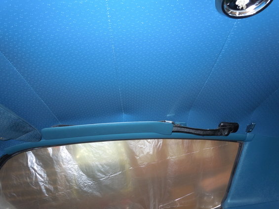

again it depends on what syle female buckel you have. if you have 2 female buckles you got 2 clips on the roof , 1 metal , 1 plastic . if you have the 1 female buckel you got the plastic channel

the 1970 did not have the same set up as a 73. the 1970 used coat hooks, a plastic clip and a piece of elastic to hold them in. btw i would not sell a good complete set of 72 belts for less than 350.00. the holder will run 50.00 or so per side if it is in nice shape
