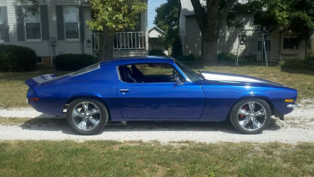

Got mine from Speedway. They are 1"

Wow nice car!!! perfect stance!! Could you take a picture of the lowering blocks????

Thank you ! I'm at work for another three hours. Ill try to get it when I get home for you.
