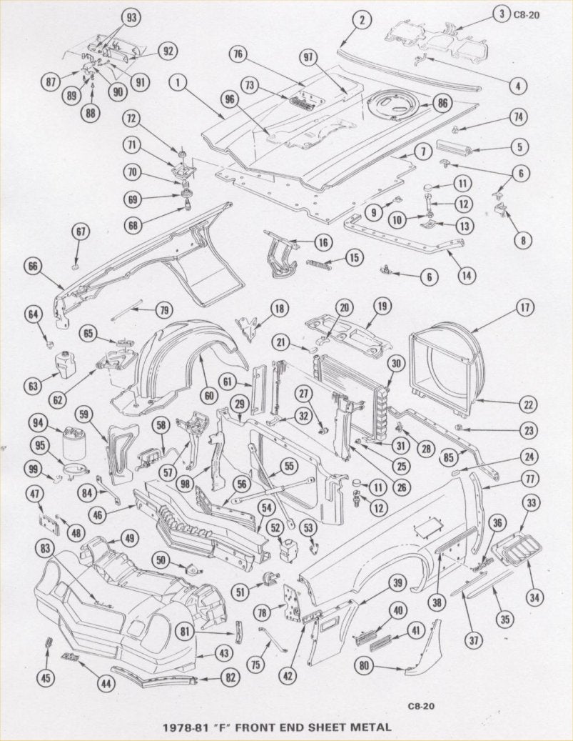

Actually they are all around the outside of it too, in various locations. The easiest way without pulling the front clip is just start L to R, tag & bag bolts and screws, and take lots of pictures as you go. Proceed slowly, the urethane nose is hard to replace but is also easily repaired most times. Depending on how hard he hit the sign, you may need to replace / repair the fiberglass piece (#49 in DIA. above) under the cover too.

is that #49 made of hard foam/rubber? because a couple of foam pieces broke off from some were underneith. iam thinking if i can pole the nose off and mend and reinforce the cracked areas from behind and bondo the front of it, it should be okay.

BTW, is your son OK? My guess is he was more worried about wrecking Dad's car than anything. #49 is made of fiberglass, emailing the pictures now, it will take a little bit. Yahoo only allows 5 attachments. Here is the thread for when I repaired the front bumper cushion ((#46) made of foam rubber):

YES they hepled a bunch!! the screws that connect the nose to the front part of fenders, can i get to those with removing a bunch of non related screws that hold the fenders?
You should be able to get to the bolts on the inside of the fenders by removing the battery and smog canister. They will still be a PITA to see. But still a very easy process. At the bottom of the fenders you will find a bracket with 3 bolts that connect the nose to the lower fender extension. Use lots of PB Blaster on those, they are notoriously brittle bolts.
