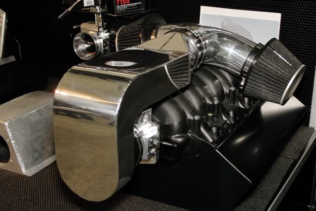

Had a thought. I wonder if I would get enough air from one of the intakes to feed the engine? If so, I could hook up the other intake for looks but block off that side. I could even really confuse people if I bought a defective MAF and installed it on that side for symmetrical reasons.
1964 Corvette Coupe, 327/365HP, TKO-500 5 speed, Posi 3:36 gears, PB, PS, Soft Ray Tinted Glass, Back up lamps, Torque Thrust Wheels, AM-FM Radio, Vintage Air
Jerry Forthofer's Car Blog
jerhofer is offline   Reply With Quote
Old 06-14-2011, 10:15:35 PM   #44
jerhofer
Location: Rockwell, NC
Posts: 491
Just found this. May have to make a call tomorrow.
http://www.shopatron.com/products/pr...0.0.0.0?pp=35&
PRI 2010 – Spectre ProFab MAFS Conversion Kits
LS engines are finding their way into all sorts of different places – street rods, sand rails, even Fieros and Porsche 996′s. Though the creativity of swappers is endless, the less fabrication required, the better. Spectre has just introduced a couple new part numbers that will be real problem-solvers for LS swaps where space in front of the engine for intake plumbing is at a premium.
Their new ProFab MAF sensor kits replace the boot-style MAF common to the LS series with a blade-type sensor, saving 2-3 inches of room ahead of the throttle body. But the space-saving factor isn’t the only benefit; Spectre says that when placed in a 4-inch diameter tube, these kits will flow up to 25% more air than stock boot-style MAFS. Spectre also claims that the blade style design is more robust and less prone to flow sensitivities than the boot type. The kits are available in 3- and 5-wire flavors, and include a rectangular bung that can be welded in just about anywhere on the intake tube ahead of the throttle body.

Here's another thing Spectre is working on. Not sure I like this.
