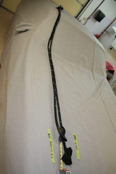

Okay, I give up. I spent big money on ebay to purchase what I thought were correct NOS Door Weatherstrip for my 71 Z28 and they do not fit. The Group and part numbers are correct on the boxes, GR10.694 1#9868430 and 1#9868431, the W/S look exactly like originals (and the re-pop's I have), but they are approx. 6" too short and the little plastic pins that push into the door do not align with the holes in the doors. The first couple pins on each end align but the rest of them have an entirely different configuration. The ends fit and align perfectly with the screw holes. These do have some numbers embossed on each end but I don't know what they mean. These numers are LH front 8291, rear 9383 and RH front 8290, rear 9382. Does anyone know what these things fit, they do not fit a Camaro door? Has anyone ever run across this issue? Here are some pics to help with the story.
So I assume somewhere along the line, way back when, some parts guy at a GM dealer was taking the Camaro W/S out of the boxes and replacing them with these; then selling the Camaro stuff.
I am currently working with the Ebay seller on getting this deal undone, but I am curious if anyone has had this problem before or if anyone knows what these fit. I also want to make this issue known to those of you who are buying NOS GM weather strip, apparently the numbers on the box don't mean much.

sometimes respawn products like the ones you compaired to gms nos are of different material, those boxes look like they have dealt with moisture maybe over years shrinking product.

That rubber wouldn't shrink that much sitting in the box. It's a China part in a GM box to be sold off as the real deal. Scam.

I gotta believe these were switched at some point ( perhaps an honest mistake ).
I fail to see how shrinkage (or stretching ) will resolve this...

The holes spacing / orientation is completely different.

Could they be for a different car and were placed in boxes with the wrong part #s? Shrinking 6" seems like a lot, esp if they are not all dry rotted or have not lost any thickness. The white pegs are in completely different spots too and not just from shrinkage (pic #4 esp).

I spoke with Mike about this some time ago ... yes this is the SECOND time the exact same thing has occurred ... same part numbers and same weatherstrips ... 2 years apart ... it is too much to be coincidence ... 2 years ago we figured they were swapped out ... this time ... ? ? ? How can the pin spacing be SO FAR off???

I also have a set of NOS door weather stripes that I purchased through my GM dealer quite a while back. They are the same from 70-81. My group numbers and part numbers are the same as yours. The embossed numbering on the ends of the weather stripes match yours. I'm not ready to put the car back together yet but I did take the seals out of the boxes and checked pin alignment. My set fits correctly.
