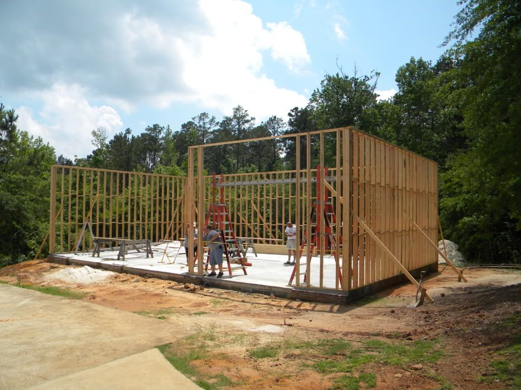

Thanks to all of my fellow camaro lovers who also have a penchant for garages/shops and or storage buildings, I submit to you my current shop build progress.
This shop started out to be a 30 X 50 Metal Shop. A customer of mine could not pay his bill but was in the Steel Building business so we decided to swap out. Unfortunately for me, I poured the footings before getting my permit and then the local AHJ (Authority Having Jurisdiction) would not allow me to put up a metal building. Oops! I should have checked fisrt. My bad.
Soooooo, after some long deliberations and kicking and screaming, I decided to make lemonade out of the lemons. Now it is going to be a 30 X 50 with a full second story and a trax type hoist system.
I neglected to take pictures of the footings but my son may have and I will try to dig those up later.

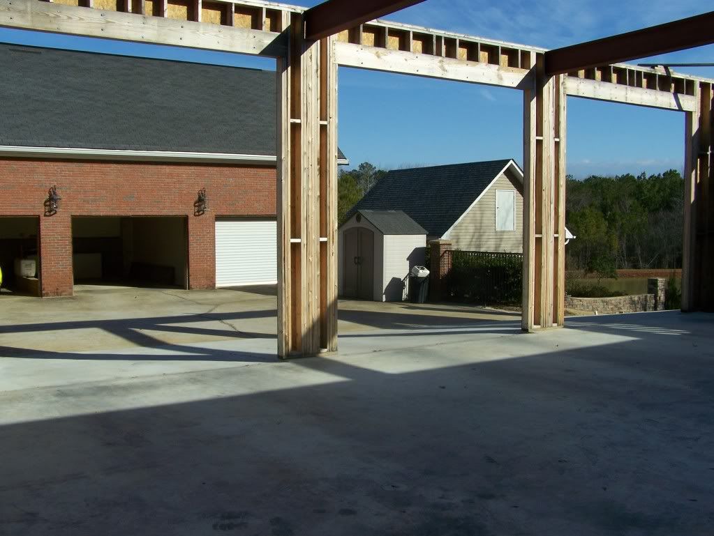

You can see in the pictures with my truck in the garage the steel beams that go from the front to the back of the building. These steel beams are 14 inches tall, 30 feet long and weigh approximately 1200lbs. each. I decided to use these for both strength and the trax hoist system.

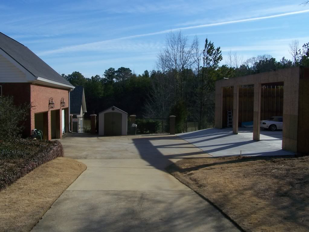

Looking down my driveway. You will notice that I can turn left or right into either of 6 bays.
Now, I only need Z's for each bay. That or T/A's.

More views looking down my driveway.
We ordered all of the materials to get the second story on last week. Patiently waiting for the space joists. Checked on them today and they are in a weather delay.
Dang Snow!
One on my toys pulled in. Turbo charged Miata.

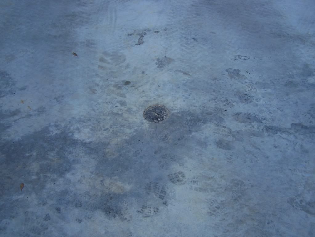

Floor Drains.
I have a floor drain embedded in the concrete in all three bays. You cannot tell it by looking but each bay is sloped slightly to the center drain. These are four inch drains that are plumbed out the back.
Floor Drains

A few more views showing the Steel beams for the hoist system and the second floor.

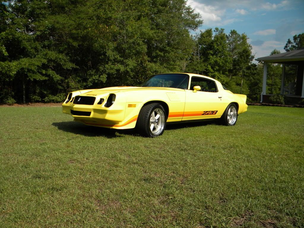

Beam shots. That is blast from the past sitting under the cover in the back ground.
Blast from the Past just in case you guys have missed it in other posts.

Great foresight on the drains. I wish I had done that when I had mine built...
