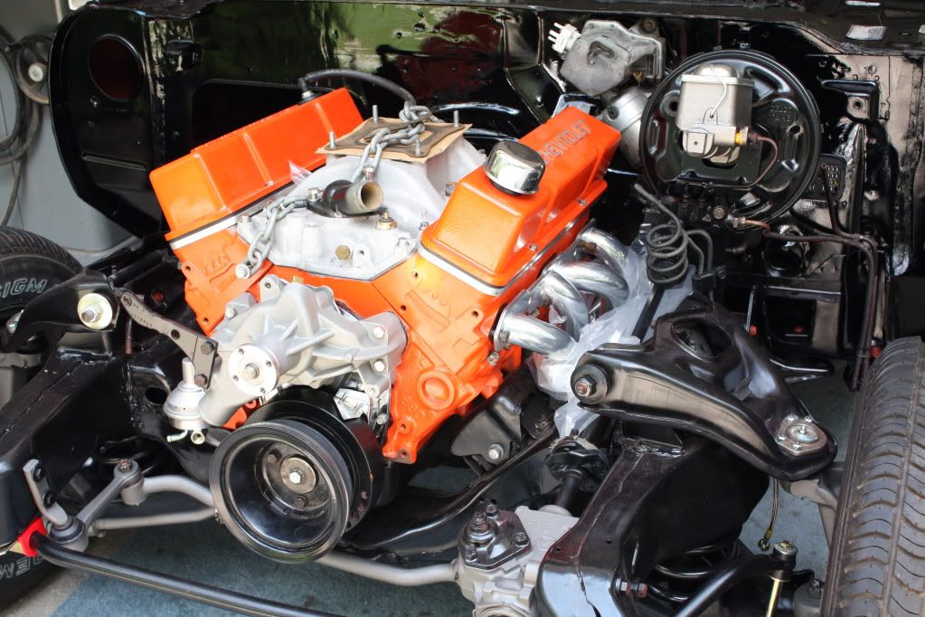

I tore the engine down and found cam assembly lube still in the lifter valley, the cylinders still showed a good crosshatch pattern. I don't think this engine had any miles on it. Plugs were completly black, terminals inside distributor were burned up, and that combined with the loose spark plugs and misadjusted lifters was why it ran poorly.
Did a bunch of research and decided to go with the LT4 Hot Cam. When I took the valve springs off all the intake valves had no seals, seems the comp cam that was in the motor had intake lift over .500 so instead of having Vortec heads properly machined for clearance PO just left the seals off. Heads got machined to accept .500 lift cam, bigger springs and screw in studs.
The motor back at home. The engine was running by August of this year, and I drove it out of the garage in October, albeit with no front end sheetmetal, and only a drivers seat for an interior.
