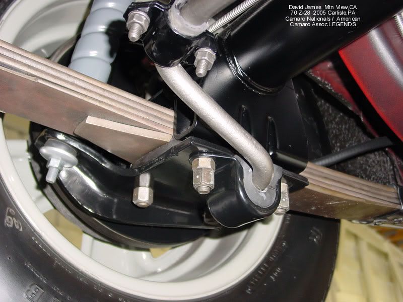

Mark and everyone, The pictures below show argueably the best restored 70 Z-28 that has ever been brought to Camaros at Carlisle LEGENDS judging.
Most of the top restored cars (all brands) in the country are "over restored". That's what owners want, and that's what car show spectators like. It sure beats the alternative where a car is restored incorrectly with monotone black undercarriage, mediocre paint, chrome, stainless trim etc etc just so-so.
I believe both cars below were painted with BASF/Glasurit.............
My lousy photograpy skills dont capture what I'm trying to get at it, but its the best I could do at the time.
