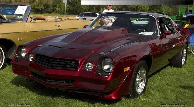

this it?
http://photography-on-the.net/forum/...d.php?t=631392

That sure is purty!
http://img.photobucket.com/albums/v2...g?t=1232204736

Man that is nice

Wow! Nice deep color.

That is a sweet color.My car is originally blue,and i planned on keeping it blue,but after seeing that now i may have to reconsider my options.

Beautiful,that color was popular some time in the seventies ....Chicago auto show in McCormic Plase convection Center

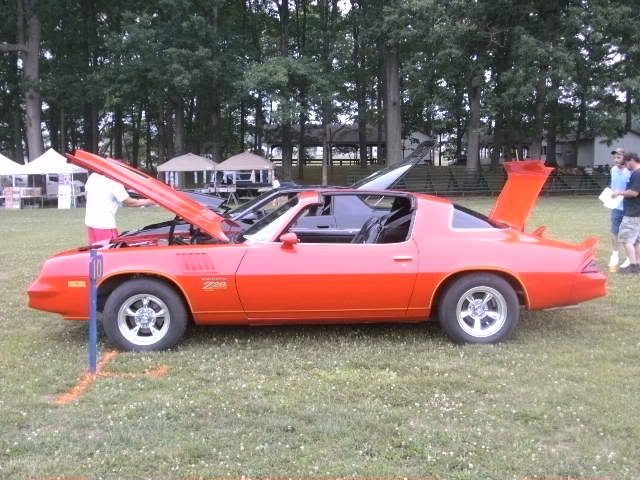

thats not the pic i was lookin for but that will work to show the wife , im thinking about swapping my stock color to that , what are your opinions on the color switch? or stay w/ the factory color

Personally I say no. It looks GREAT the way it is. I think that other color looks nice, but I like the stock look better myself.

before anyone says it i know its my choice ,but im really torn between the two and ill use the feed back i get to help my decision when i get it repainted

I like both. Both on my list of choices for mine (or something similar). I do like the 75 factory color code probably more than any other. Don't think you could go wrong in any way with it. However, I'd choose the brandywine over it by about 1/2 a %.

If it were as simple as laying paint down,I would be a positive yes. You do need to know,that paint like that isnt just something that even a decent body shop can lay down out of the can. That paint starts life as a large amount of very expensive paints,and needs an expert painter to lay it down. Thats a about 3 quarts of base color such as black or silver,followed by about a gallon and a half of candy color then followed by a gallon of clear,and all those gallons and quarts are EXPENSIVE. If your paint guy is used to doing production type work and doesnt have the tools or skill to lay it down,it will end up looking like paint soup. If you had a car ironed out razor straight,sealed,blocked,taped up,wiped down and parked in the booth ready to paint,a good shop would hit you about 3 grand just to go into the booth and apply the paint and supply the materials,then hand you the car back as is.

+1^ Candy colors are awesome and I wanted to do mine in Candy Apple Red at first. But then I found out the costs and how difficult it is to do correctly and evenly (I wasn't painting it personally). The other thing to consider is if you get any chips or scratches in the paint you can't just touch it up, you may have to do the whole panel and then matching the original is unlikely. That's why I decided on a base/clear combination in a color that's close to candy apple, at least for me.
