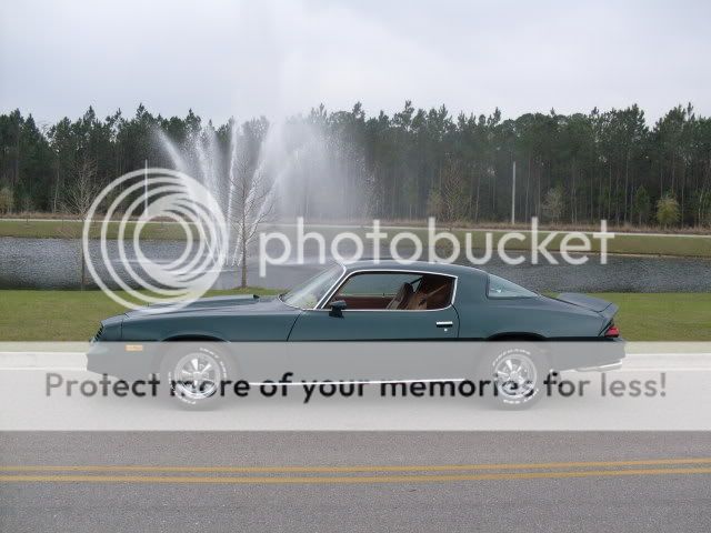

Here is the car I'm starting with:
Marshall
