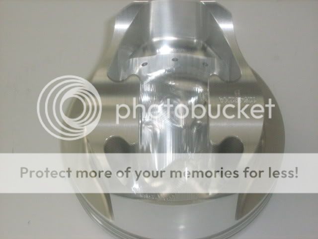

Just to compare to off the shelf pistons, you can make a better decision based on the information below
This is a set of Custom Ross Racing Pistons. I myself look at Probe Industries and Keith Black, then if I need a custom Ross Racing Pistons is the way to go "In My Opinion"
These are solid domes and very thick decks with lightening, Notice the dome shape/profile,,,
Piston specs and pics
Bore - 4.060"
Compression Height - 1.375"
Top ring - .031"
Second ring - 1/16" back cut
Oil Ring - 3/16" 5-10 pound (I prefer the 3/16" groove for larger drain back holes, just my opinion)
Effective dome cc's - 14cc's
Dome height - .400"
Intake valve pocket depth - .305"
Exhaust valve pocet depth - .260"
Pin - .927"
Pin wall - .150" Thick Wall
Pin weight - 119grams
Deck thickness front - .510"
Deck thickness rear - .515"
Minimum thickness under intake pocket - .206"
Minimum thickness under exhaust pocket - .289"
Minimum thickness of deck & dome combines - .910"
Intake valve pocket to top ring groove - .108"
Exhaust pocket to top of ring groove - .122"
Skirt - .139"
Side relief - .102"
Thickness at fire slot - .751"
Pin hole to side of pin boss - .086"
Pin engagement in pin boss - .625" per side
Weight
453grams
453grams
453grams
454grams
453grams
456geams
455grams
453grams
Here are the pics,,,
Top Side View
Bottom Side View showing all the internal lightening
