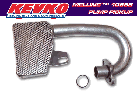

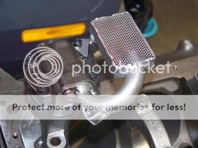

I have the same pump for my new engine.I have read about this pickup having issues.The bolts can come loose,or the gasket could fail. I had a custom pickup made for mine that both presses in and bolts on.To me this is a much better and safer setup.
Here is a generic pic of the pickup I used.
http://www.kevkoracing.com/images/me...ickup_full.gif
I called them and they made the pickup to fit my 8.25" deep pan
This is mine

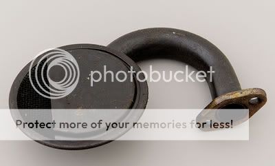

The pickup you listed, http://www.summitracing.com/parts/MEL-12558/ does not press in. It only uses the 2 bolts and a gasket to hold it on. The pickup I have has an extended tube that presses in,and it bolts in after it's pressed in to place. I have seen pics on the net of the Melling pickup breaking off at the flange,and have heard of failed gaskets and bolts comming loose.
Here are picks of both.Can you see the difference?
