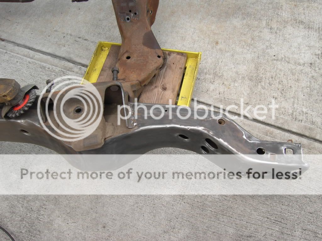

This picture shows what the subframe looked like before I started cleaning away the rust, dirt, and grime. You can also see a section I have completed and my tool for getting this mess off the metal. Aside from sand blasting, the wire wheel on the end of an electric die grinder works tremendously well. You have to wear gloves, eye protection, and ear protection. The thing is a monster. The only downside is getting into tight spaces. It really can't do that very well but if you're working quickly and on a tight budget, this thing works wonders. It'll also tear through undercoating pretty well. The wire wheel won't harm the metal like you would think it should.

All clean and wiped down with Ospho to convert any rust still on the metal.
Here it is all primed and painted. From using the wiring wheel to clean the metal to painting, all I did was clean away any crap still left around with different solvents. I didn't need to work the metal any more as far as sanding goes or anything. See, the wire wheel doesn't harm the metal.
And back on the front of the car. I have GW 1/2" drop body bushings on the car. To align the subframe, there are two alignment holes in the body right by the forward body mounts. You'll need a 5/8" dowel to slide into the holes in the subframe and the body to get the alignment right. It turns out that my 1/2" ratchet extensions are close enough to 5/8" that I used them to get the subframe aligned correctly.

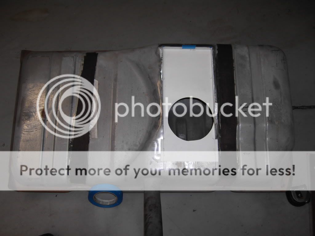

Here's the fuel pump and sending unit out of my 96 Formula. My 4th gen tank was metal so I was also able to cut the top off so I could have the mounting ring and seal to adapt to the 2nd gen tank. The sending unit is spring loaded to force the pump down onto the bottom of the tank. It also has a decent range of motion so you should be able to use it in many different tanks. The gauge sender even has full range of motion inside the 79 tank so I will have accurate gauge readings. It does not have it's own sump or internal pressure regulator like a late LS1 4th gen would have. Again, I'm on a budget and this will work just fine. I'm crossing my fingers that this fuel pump with 177k miles on it will still live for a while yet in my 79's tank.
Here's the 79s tank with the outline of where I plan to cut the tank and install the 96's pump.
I ended up cutting further than I thought becuse of a large cylinder object on the inside of the tank around the return tube inlet. Notice the raised ring? That's got to come out as a unit.
The idea of how the 96 pump will sit in the tank. It should be obvious at this point that it will indeed work just fine. I'll have to change the metal lines coming out of the unit but that's no big deal.
Poster board mock up of the replacement panel.

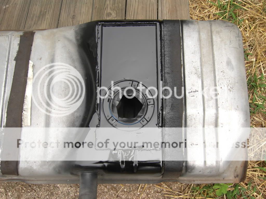

New panel and mounting ring from 96 welded in place. I had some more in between photos of what I did but they too were corrupted. It's pretty self explanatory though. Just make a panel that hold the mounting ring and use fuel pump in the correct location. The later larger 2nd gen tanks need to make sure they are far enough into the large section to not have the gauge sender float get caught on the lower section. It won't read accurately then. You early 2nd gen guys with the shallow tank should still be able to use this pump and sender if you desired. You'll have to shorten the arm on the fuel lever float though.
Also, my welding sucks at this point in time. I'm getting better though. Feel free to laugh at it as well. If you can tell what I may need to work on in terms of my skills, speak up. I'm never above learning a new way or listening to advise.
All painted and protected since it was 22ga steel and I removed the zinc off the tank to do my welding. Notice I taped up where the seal will seat to make sure nothing interferes with that seal working correctly. The tank and new panel shouldn't leak..... too much.
