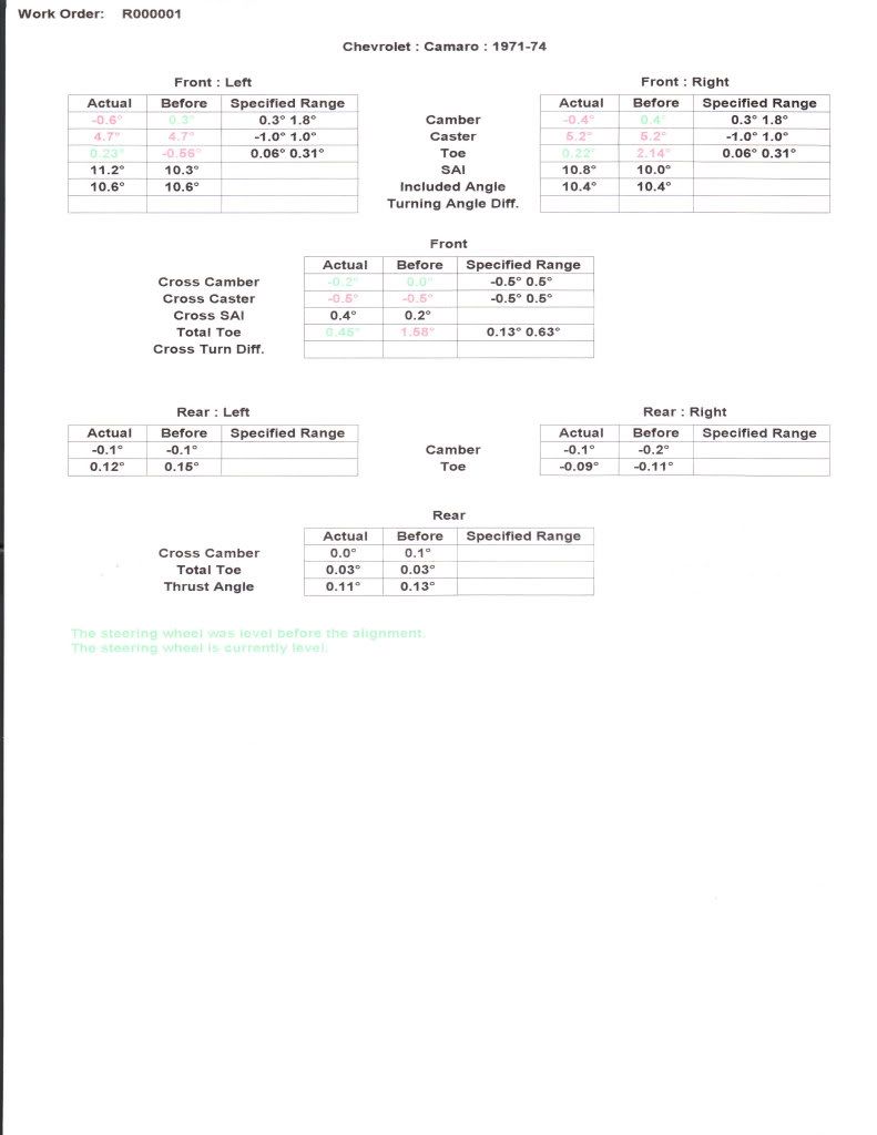

For those that are interested, here are my alignment specs from my first alignment.

That looks great compared to what most people get from alignment shops. I would want a little less cross caster but for a street car its going to be fine. I bet it handles great

What's the numbers?...they have blocked me on our server here at work, so I can't see what Scottie posted.

He's got -.6°/-.4° camber, 4.7°/5.2° caster, .22°/.23° toe.
So he's basically got the good performance alignment of -.5° camber and 5° caster.
The cross caster and camber numbers are what my boss recommends for street driving, as they compensate for the crown in the road, so as you drive down the road the car will want to go straight.
If the car was going to mainly be used on flat surfaces, like a runway (autocross) then you would even those numbers out side-to-side.
That is a nice alignment.
you are right on my friend.....on a road with a good crown to it.....there is a slight drift.........but on a flat road very very nice ride!!

my experience on a bunch of cars has been that a couple tenths cross caster is okay on a street car, but more than .2 or .3 cross caster can cause a caster pull that is annoying on less crowned roads (highways). Although if the car drives straight it's fine
