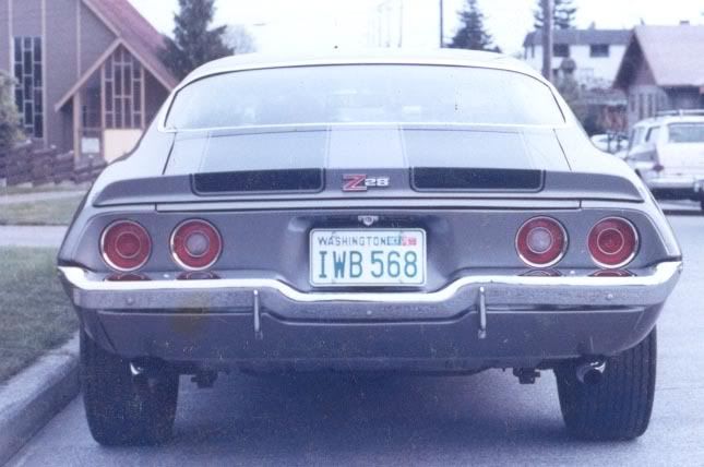

My April built 70 has the tall rear spoiler. Didn't have the front one when I got it. When I got it I was considering putting the one piece rear spoiler on it because it looked better but couldn't find one locally back then.

124870N531881 VIN with a body # of 260992 came with a 9796 spoiler. Took Delivery early May. Hope this might help in your investigation. The quality of mine was ???? It had air bubble holes in both end caps. Wish I still had the car but that is another story.

My 04D Z has the tall rear spoiler. It also had a front spoiler at one point, but it was missing when I bought the car.
I was under the impression that '70s didn't have come with a front spoiler. Is it possible (I know, no way to prove) that my car came with the front spoiler?

My 06C LA built Z has 1 piece low spoiler.
My understanding is as al8apex stated....and in '70 that option did start at the beginning of the model year nor did it include a front spoiler.

My April production 70 Z did NOT come with a front air dam. I did later in 70 purchase one from the dealer and install it. It did arrive with the tall rear spoiler. I do remember AO Smith embossed on the inside of one of the end caps.

You must have had to drill more holes to mount the spoiler. My May car only has 2 total drilled out holes where the front spolier would go.
