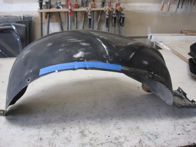

the fender goes above the inner fender and what material that would be removed would not bee seen, all you would be doing is moving the 90* radius circled in the photo out toward the wheel, the the fender would ned to be clearance so they would bolt up together, comprende???? Clear as mud! I will have better photos when I actually start this next week, hopefully
Keith
Um... clear as mud indeed LOL. That sounds fine by me, I just wanted to make sure you weren't talking about where the inboard side of the fender meets the wheel wells, because I know if I had to cut a curve out of the fender myself it would end up with the fit quality of a Yugo. Or just look like I attacked it with a sawzall.
One more thing to clarify, the exterior dimensions of the wheel wells are going to increase height wise obviously to add the additional clearance and fill in a lot of the OEM stamping; but they aren't going to move inboard towards the engine/frame at all correct? I ask simply because I modified the factory steel "L" bracket that the distribution block is originally installed on for my rear proportioning valve and its sandwhiched snugly between the steering shaft and the back of the DS fender well with no where to relocate it.
Actually the wheel opening size or sape will not change at all. What you will need to trim is the part that folds back 90* to the fender, And not a lot, these won't solve world piece either, Oh yea no worries on the bracket you discussed, and no these won't fit a Yugo
What 90 degree part on the wheel well do you have to trim? I don't understad.
the part that is parallel to the top of the tire, the 90 degree bend, it needs to be trimmed 1/4" or so, that is how you get the tire clearance. i will post pictures next week

here is the progress. I have stripped and cleaned, I have welded up all non essential holes, and removed the raised boses on the battery tray area, which will be smoothed out, also the drived side front will be smooth and flat where the charcoal canister mounts. The blue tape is the area where I will add material to to bring the inner fender lip out about 3/8", which is why you will need to trim about a 1/4" from your fender where it returns and mounts to the inner fender, (only at the top of the opening) Any questions please ask. www.customworksproducts.com

Hmm... what if my battery isn't moving? Will these fenders be able to support my 39lb Optima Red Top?
If so does that mean I'll have to drill holes for the bottom 2 battery tray bolts???
To answer your first question, yes, but you will need to likely brace the bottom where the battery goes and tie it to the subframe, we are talking some 1 1/2"x 1/8" material likely.
2nd question, answer is yes. Why not put the optima in the trunk. Sealed cells are great, no rust, so the trunk is a great spot. Hell most guys drive around with either a bunge or nothing holding the battery in, So if your forking out the $$$$ for trick carbon fiber parts I am assuming you can handle making you battery installation look and function adequately.
