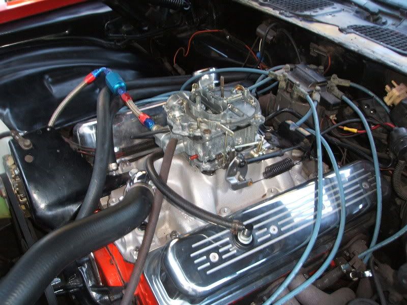

I thought I would share some pics of my rebuilt QJet.
I bought a rebuild from National Carbs. The carb was custom made with proper jets, rods and hangers for my engine. The also modded the idle circuit for my low vacumn condition. They also sent me 3 other secondary rods so I can play with 1 leaner, and 2 richer secondary rods. For the Qjet fans, I would highly encourage others to buy here. I believe I paid just over $200 for everything.
I used to have a JET stage 2, and I will say this qjet is just as good, if not better. Flooring it off from idle is deffinately better than my JET. I am sure if I knew how to mod the JET I would get the same effect, but this carb was out of the box and go. Throttle response is really quick, and has a very smooth transition to the vacumn secondaries. Absolutely no bog, and I had it up to 6500 RPM, and it would still go more.
Here are some pics below.

I'm surprised they used the truck/boat style rear vacuum break. Nothing particularly wrong with that except..... where's the linkage to pop the choke open a little on a cold start? That could be an issue for you on cold start-up (flooding out the engine shortly after start-up).
I am NO carb expert, but the linkage to hold the choke open on a cold start I believe is located behind the electric choke. I can tell you I started my car on Sat morning and it was about 60 degree. I was playing around with setting the elec choke position. I held my peddle down to the floor, and when I started the engine, the engine idled at 1300 RPMs. It slowly came down and settled at 900 RPM which is where this engine idles.

The linkage to pop the choke open immediately after a cold start always comes from the vacuum diaphragm. They're different looking linkages, obviously, depending on whether it's a front or rear mounted vacuum diaphragm but they are always there.
The other alternative is to set the choke element very loose and let airflow pull it open. Not usually a good alternative- you always end up adjusting it every time you have a significant temp change.

Your engine and carb look very nice ! The Q-Jet is one of the finest and most accurate carburetors ever designed.
I'm curious about the finish of the metal on the main body and airhorn castings.
Is there some reason that the carb does not have its dichromate conversion on the upper and lower castings?
A lot of shops cannot do the full gold color anymore because that requires hexavalent chromium, which is extremely carcinogenic. Trivalent chromium is safer, but gives a distinctly olive drab cast to the surface conversion. I'm wondering if the state where this carb was re-built has outlawed the remaining chromium material for use.
As an aside, about metal chemistry in Q-Jets...
I've built about 400 Q-jets, roughly, over the years, and I noticed that the Carter-built versions have inferior metal chemistry in the castings. These carbs (which were built by Carter on contract when Rochester could not keep up with GM production requirements) have much greater intergranular corrosion when left exposed (i.e. junkyard in the open), but even with the trivalent chromium they "gold" better than the Rochester versions.
Never run a Carter-built Q-Jet if you can avoid it. They are inferior versions, even though produced strictly to standard.
Here's an example of how poor quality metal chemistry can do you in without every really being able to figure out why the carb runs badly:
See the punch marks in the casting to retain the power piston's little collar? This is a standard retaining technique on older carbs which have been re-built several times, but on a Carter built carb the metal will often crack during the punching without being obvious to the average shop employee. This will cause the carb to run mysteriously at times, due to vacuum leaks, erratic piston action, the effect of various temperatures on the cracked metal, etc.
No matter what, you still have a pretty nice looking setup going.
