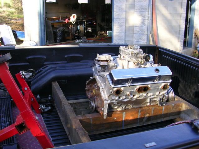

Its prety easy to make a cradle out of 2X6's cut to length and nailed or screwed together. I'll post up pics when I get home from work.

As promised:
Real easy and secure!

wow, that's impressive, Mark. Very nice!

Thanks,
Just four scrap 2 x 6 and a little thought. Cut em to fit tight between the wheel wells and measure the width of the oil pan. I did add some blocking to keep it sliding forward/back.
My brother bought the engine and took it two hours home and never even knew it was back there.
