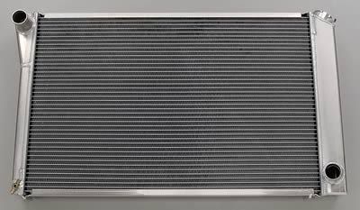

I was thinking about this one but does it have the same meassurments as my stock radiator have?
Overall Width (in): 33.000 in.
Overall Height (in): 19.000 in.
Overall Thickness (in): 3.000 in
The price of the radiator doesn't matter much because it's the shipping that is the expensive part.

I have seen that one too but I want an all aluminum radiator.
