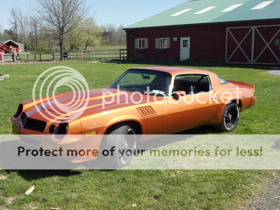

Here's a little picture I took today when I got it home, enjoy!

Car looks good! Did they replace the cam? That is where the leak is most likely to start. You could try cleaning with brake cleaner and then smearing silicone alng the edge where the timing cover meets the oil pan.
