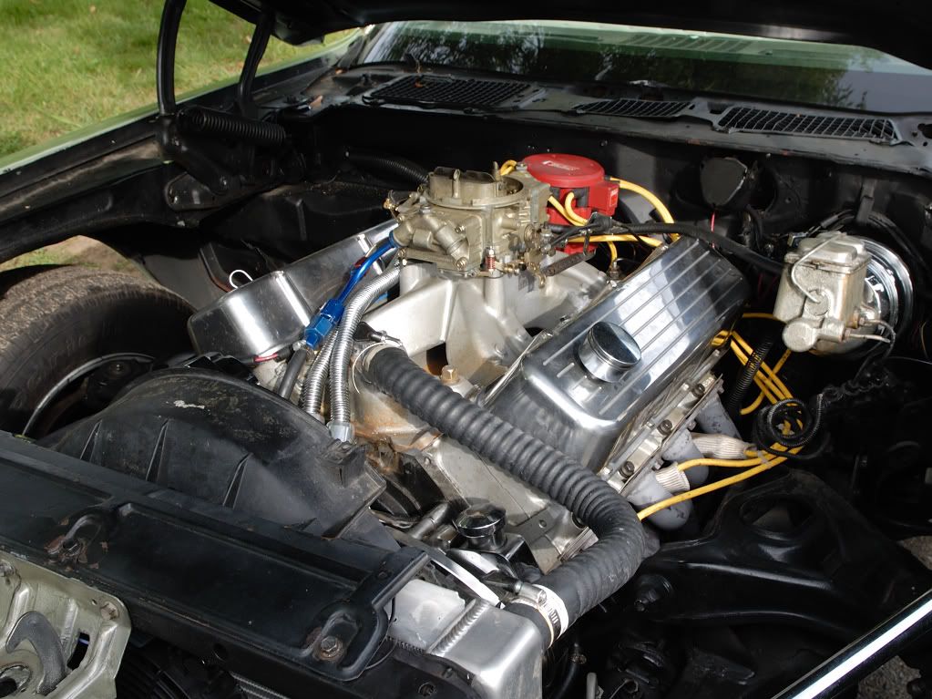

OK, Update.. The jets are 80, The 0 is just hard to see, The power valves are 6.5, My son says with the big cam I have and low vac I should try 4.5 power valves and maybe a 75 jet.
The cam is a comp 598/598 heads are Merlin rec ports.
Input?
Thanks again.
Bill
A rule of thumb is to have the PV 2 lower than the vacuum your pulling at idle. Have you put a vacuum gauge on it? What is a comp 598/598 cam? What kind of motor is this? Maybe an 850 is just too big?

Update: Car is running great, I removed the 80 jets and installed 74p/76s and changed the pv from a 6.5 to a 4.5, I am also having a air filter issue, The filter I can fit under the hood is not letting enough air to the carb, Not sure what I am going to do about this...lol
The motor is a 468 BBC with Merlin rec port heads, Not sure on the compression yet. It has headers and a big cam.
Just got the car last week and I have a lot of cleaning up to do
Thanks for everything guys.
