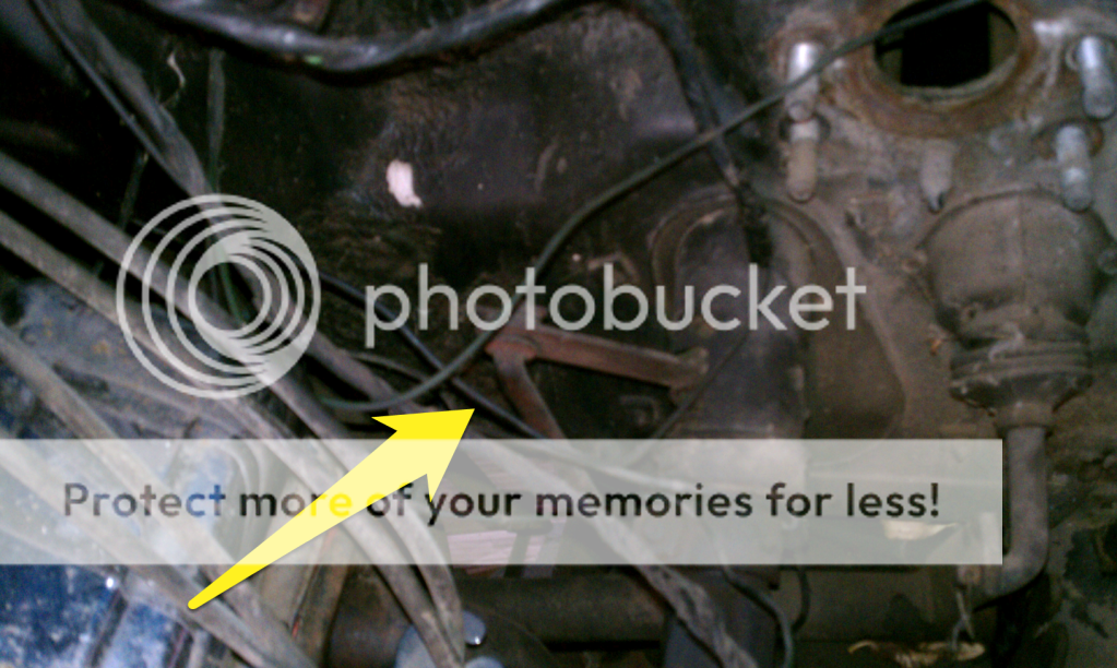

Check this out -
Looks to be the original column shift linkage - is that correct?
Can we yank this stuff to clean up the engine bay/underneath? Is that breaking all sorts of unwritten codes? We probably can't get rid of it ALL, but the majority of it is just hanging there, hooked to nothing.

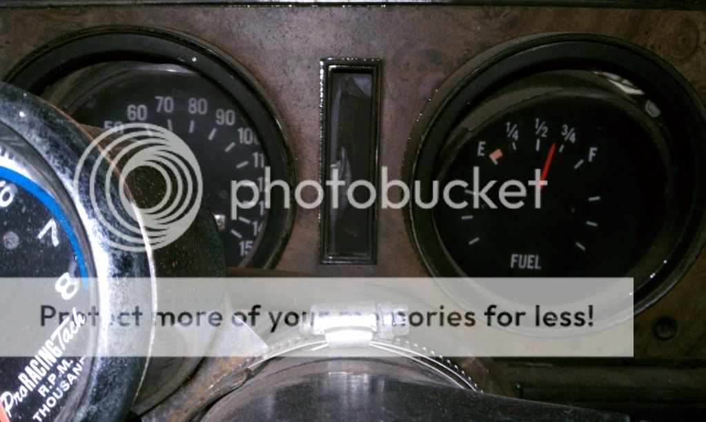

Yes, that would be the original column shift linkage. If the car was originally equipped with a factory console shifter they often STILL put that linkage there just to move the PRND2L indicator on the dash. My 74 GTO (aka Pontiac Apollo, aka Chevy Nova) had such a setup.
Whatcha gonna shift with?

Our car has been converted (at some point in her former glory) to a manual transmission car with a floor shift setup. Not sure if the car was originally an automatic or not - I guess we could do a bit more research on the VIN # and see what we turn up.
Our dash looks like this:
