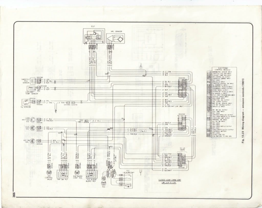

I read a couple of threads on disconnecting the computer harness on a 1981. it sounds like it's pretty straight forward but i want to make sure. Hopefully this picture will help. The 2 connectors that are close to each other plugged into the computer. The connector by itself plugged into a harness that goes up into the dash over the steering column it seems. What is this for and do i need any of those wires in that harness.
The connector by itself is the wiring for the torque converter lock up ( part of the brake switch), park neutral switch, check engine light, diagnostic connector link etc.
You can look at he diagram below to trace the wiring that is used by the ecu.

So i have to strip that harness and seperate the wires for the ecu and reconnect the other plug and related wires? I hope that wasn't a dumb question. It's just that wiring can be alittle intimidating for someone who has never done anything like this before. Thanks

If you have the subharness that plugs into to it, you are good to go. You should not have to seperate anything.
