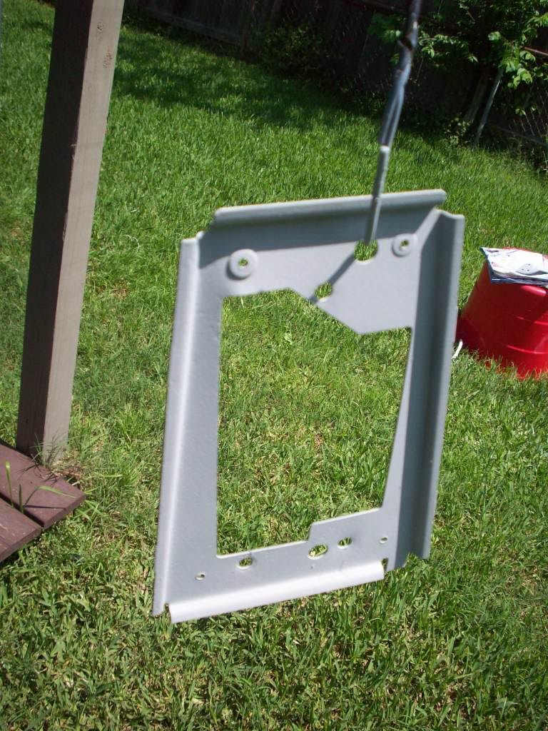

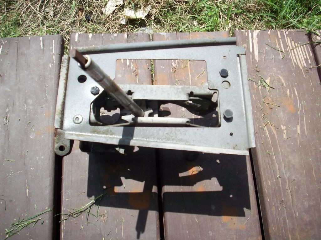

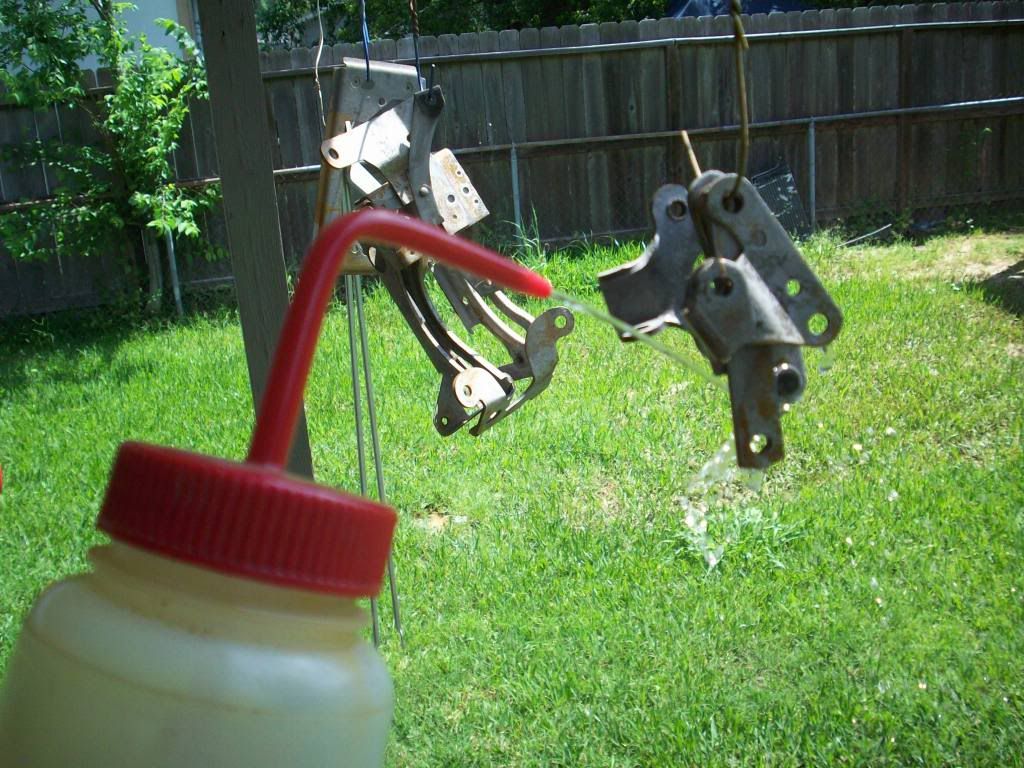

I'm talking the safest, easiest, and cheapest way to remove rust.
Not sure why anyone would hook a battery up to a metal bar dipped in liquidto do the same thing that $2 a gallon would do
Here is my current set-up (without using a current )
I always dunk it and .... Forget it!!!
Pull it up, spray (pressure washer or garden hose) the rust right off. Squirt some Acetone to get rid of the water, and prime!!
