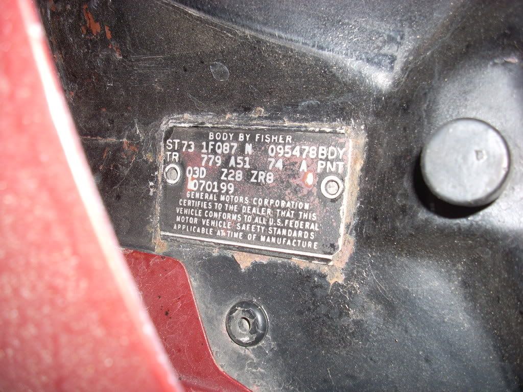

If I may add my 73 trim tag the f seems to be in the wrong spot.

there are 7 "F"s on the TT ( unless your car was built in June , then 8 ). which one ? my 73 . the previous owner scuffed to " enhance" it . it looks like it may have ben done to yours too . i have full confidence in my tts originality . yours looks fine for a 73

Thanks two zs mine looks like yours -the z28
