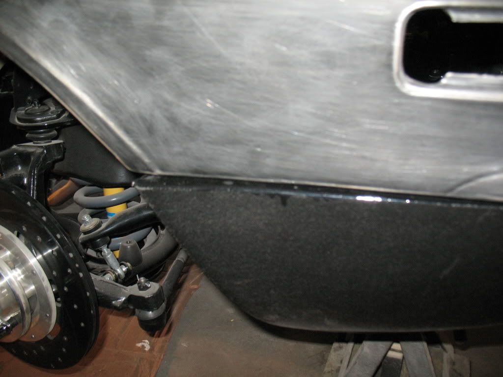

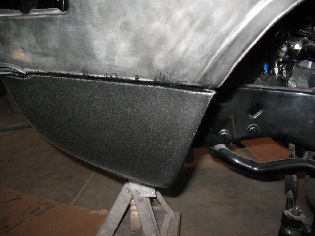

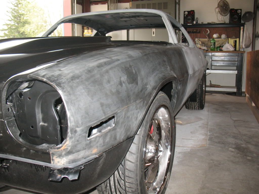

Got the front sheet metal hung and all the bolts in..still needs some tweeking

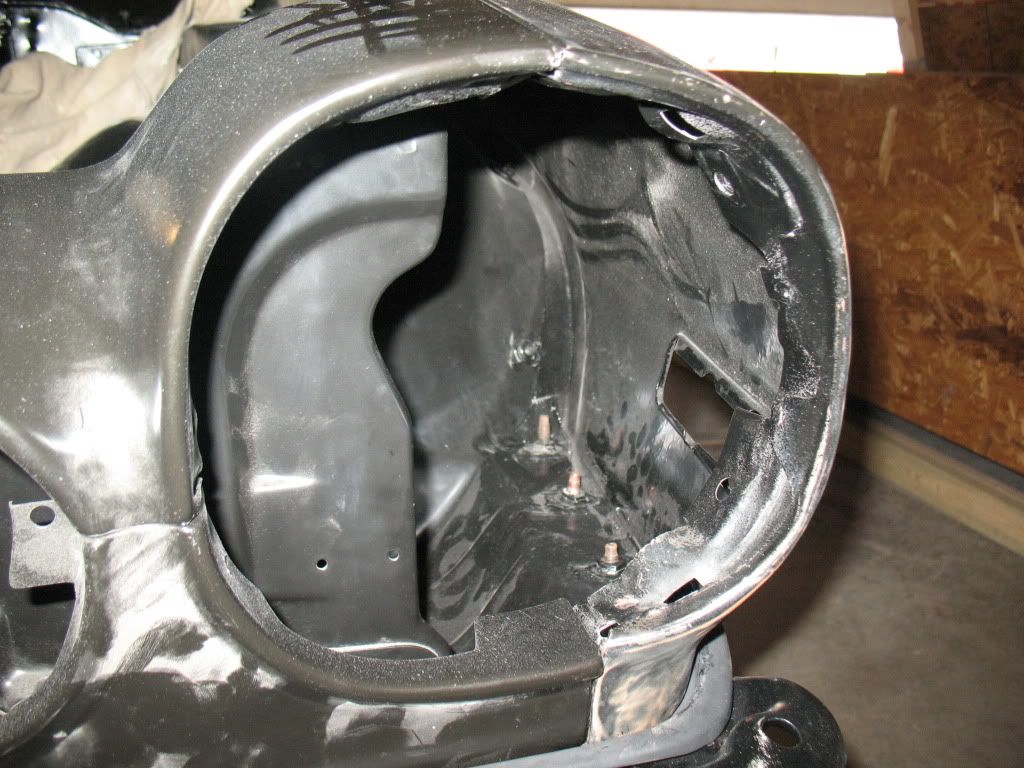

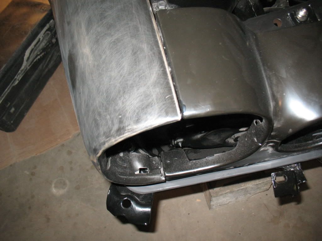

needs some work here
and here
Oh man and here on the pass. side
Driver side came in alot better

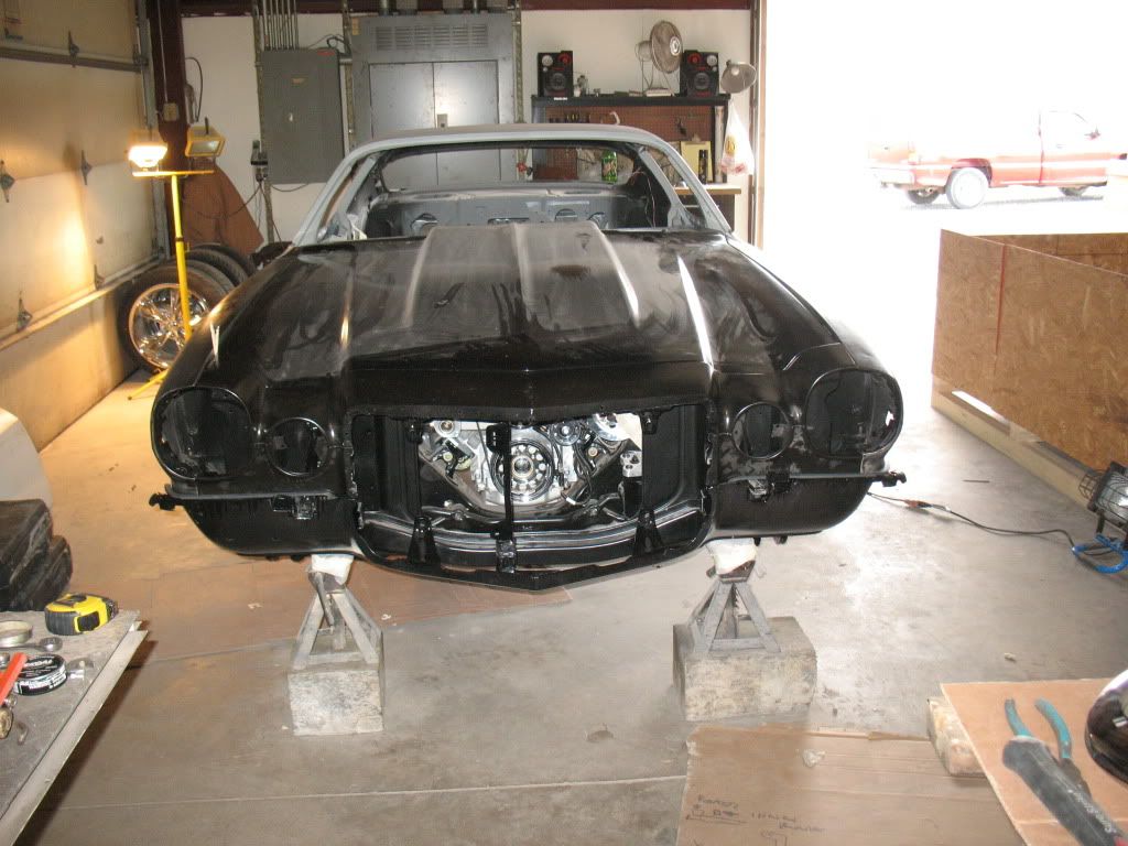

Put the hood hinges and hood on. The gaps between the fender and the hood are way to large so I'm gomma have to come up with a way to close them some. I'm thinking I will just build off the fender with some long pieces of sheet metal to close the gap and then just duraglass the tops

This weeks time was spent on the front sheet metal and hood, trying to get everything to line up. Still have a ways to go! The hood is really giving me some troubles the lower val. panel was a fight also but I've got it to where a little body work will get it

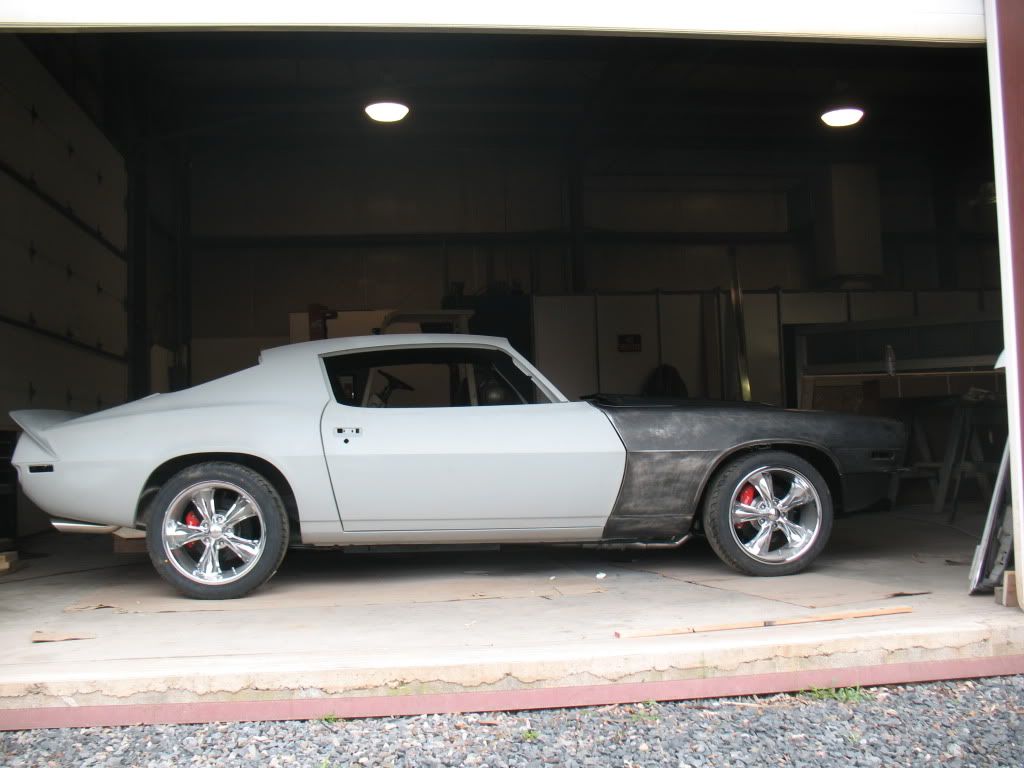

I put it back on its wheels this morning. I wanted to let everything sit for a few days before I tighten everything down and do the last of my tweeking. I'm trying to use as little bondo/filler as I can on this car but I can see it wont be totaly free of it. I guess I knew that all along though. I'm pretty happy with the stance of the car. I belive it will still come down alittle after it sits and when it gets it's first shake in.Plus it doesnt have all the weight in her. Still needs the radaitor, glass, and all of the interior yet.If it comes down another inch I think it will be right where I want it. If not then the next set of tires I may need to go to a larger profile. What do you guys think?
