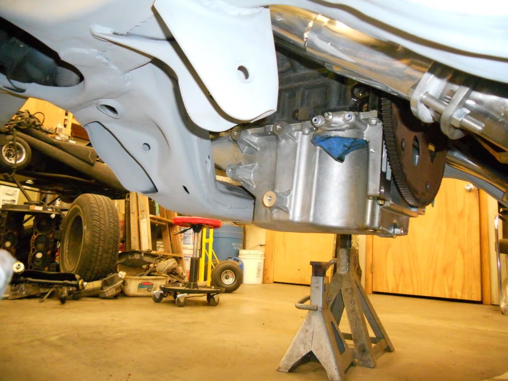

CTS-V pan with BRP Mounts reference pic
Originally Posted by OsborneConst
I am running a CTS-V pan with the BRP motor mounts, and the pan only sits about a half inch lower than the crossmember. I guess it is still the lowest point on the car though.
