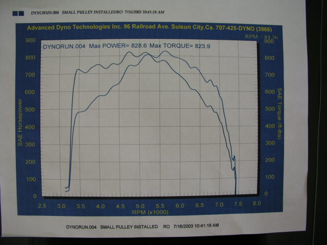

I gotta share... Jody's old car, just because I love it
Chassis Dyno:

Torque monster!!
