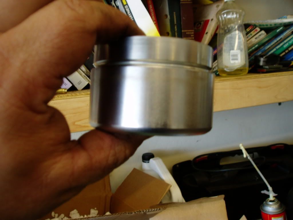

The piston is fairly bad, but will clean up.
A little brake clean, elbow grease and a scotchbrite pad and we have a usable piston again. You can use krocus cloth or if you're careful a wire wheel. It has to be smooth. Any pitting or groves means you need to replace it.
