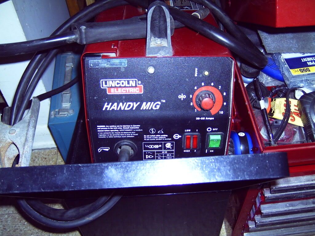

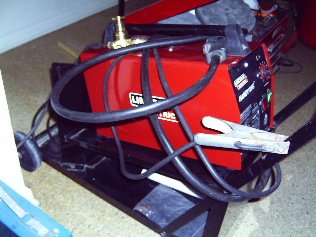

I will be hunting a bottle tomorrow because I got the welder today. I thought about seeing if he would take $150. for it but as you guys said its worth the $175. he was asking so I did not squabble over price. I got over to his house and he had it all hooked up ready for me to try out. Said he bought it for a 66 mustang he was restoring and used it once and ended up laying fiberglass over the spots instead of welding patches. Now I can not wait to play with it tomorrow as its been about 10 years since I last used a welder so I hope I can get a bottle and a helmet tomorrow. Here are a couple pictures of it in its new home.
